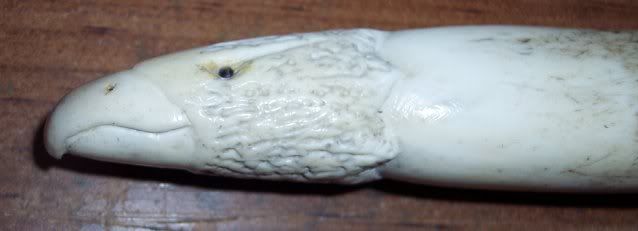

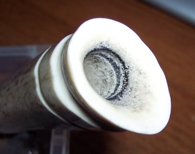

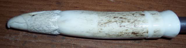

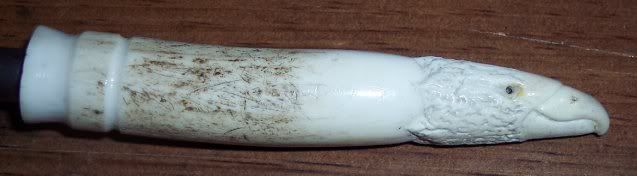

Postby Charlie Sometimes » Sun Sep 12, 2010 10:00 am
Haven't sealed the hole yet, but I did get pictures!
The hole liner idea would work, I was test fitting a few cartridges into the hole, along with some thin wall tubing.
You could even smear epoxy in the hole and redrill, I think, too, giving the walls a smoother finish, and the ability to be polished as well.
I marked the hole at two different levels with a permanent marker for different charges, too. In this case 60 and 65 grains. I can still drill the hole deeper yet if I need to increase the charge, too.
This is a tine off a 6x6 Elk rack, or so I was told. It's about 5 inches OAL.
See what you think on my first attempt at carving-

Postby TradRag » Sun Sep 12, 2010 10:32 am
Charlie, that is sweet! Fine job for sure. I'd be happy just to het the hole right for my charge let alone any carving. I hope to work on mine after my elk hunt I leave for this week. I've got a nice whitetail shed that I hope to get an 80gr charge out of. Keep us posted on the 'seal' job as I'd like to know too.
Re: making a horn powder measure
Postby Captchee » Sun Sep 12, 2010 12:57 pm
nice job .
funny how the ends of these allways call for an egale head ? some how it just fits .
i do that ame head for vent picks .
i also have done bears heads on thicker pieces

Re: carving my measure
Postby Charlie Sometimes » Sun Sep 12, 2010 4:56 pm
Thanks, guys!
I might still work on it some more yet got to think on the next parts.
It seems a bit naked behind the head, and I want to secure it on a leather thong/lanyard, or some such to my possibles bag, so it can't be lost.
As is, how would the shoe polish patina make this look now, do ya think?
