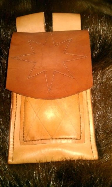

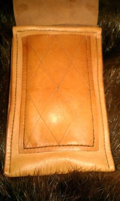

Sewed this up with selling it on my mind, then the wife took a shining to it...so she gets it. Little belt bag that was sewn with waxed linen and then browned in the sun, then oiled up good with bear grease and mink oil. I engraved a celtic cross on the front flap. Its about 4 1/4" by 4 1/2".

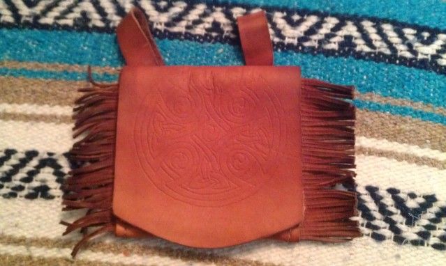

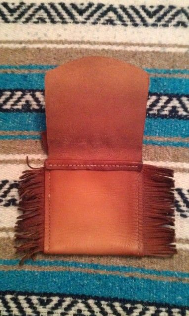

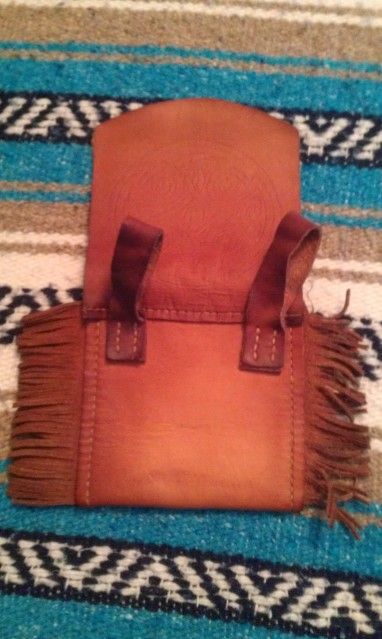

Here is another bag that I finished recently for a young buck... I've been trying to use up some smaller pieces of leather, so not enough long stuff for a strap. So belt bags fit the bill.
