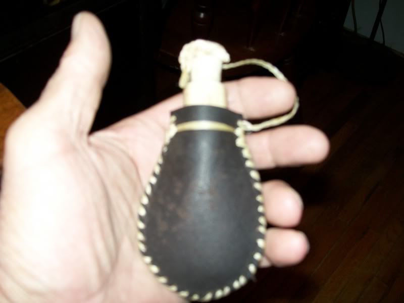

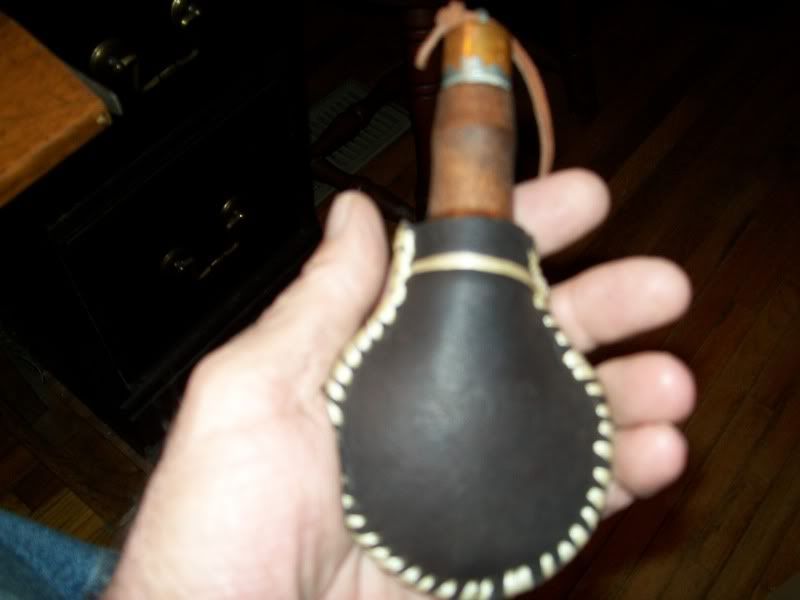

Postby Linc » Thu Jan 05, 2012 3:25 pm
Here are a couple of mini shot bags that I just finished working on. The smaller of the two holds 6 charges of 1 1/8th ounces plus a little extra for spillage. The larger holds 10 of the same charges plus extra. The copper plug is also an 80gr measure for powder or shot.
Linc

Very nice! Looks great!

Thanks for the kind words. Thanks also for the tip Captchee. I need lots of practice on my soldering.LOL.
