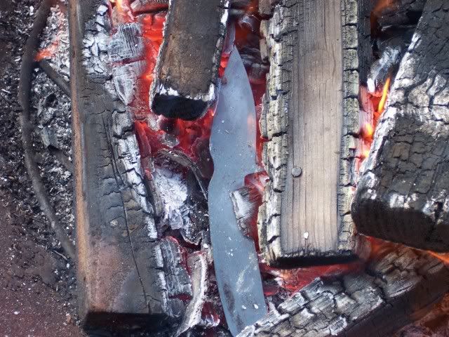

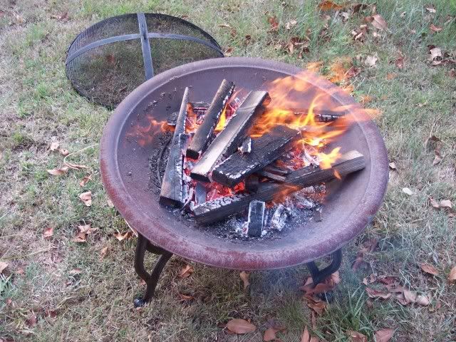

Ok, wind was calm, rain looks like it's gonna stay on top the mountains.... Lets build a fire !!!
Just as the fire got going, when the fire dept down the road got a call, the blaze wasn't even big yet when they went screamin by the house.........yes, I did start breathin a little easier

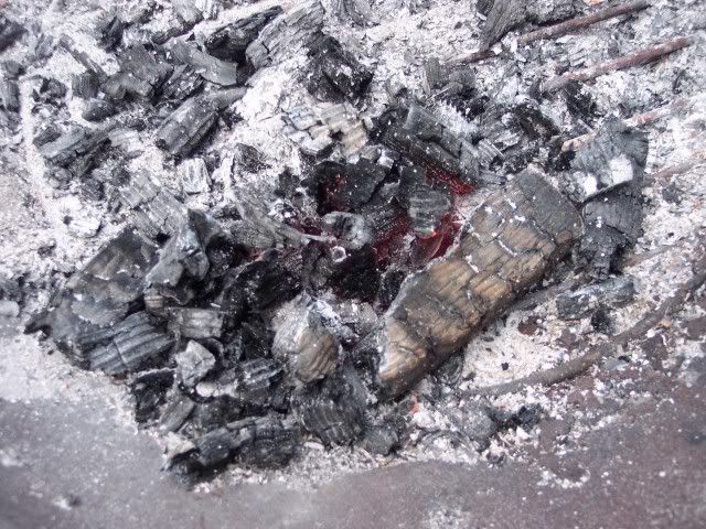

got the blank right on top of the coals and waited for more coal and then I cover the blank completely in the reddest hot coals in the Islands......well except for the brush fire........but I didn't have anything to do with that!!
the pic that was supposed be here, is in cyber space so picture this, blank in slip jaw pliers and the magnet not stickin Ok got it? good cause there ain't a picture of that.
Ok, on with the fire stuff...... where was I? oh yeah, I'm happy because it's workin Ok Happy Dance
Ok enough of that, now you said i gotta wait right till it cools down? well shucks........ I cover the blank with coals and ashes so it's under here somewheres...... waitin to be dug out when it get cooled down.....what next week?
Ok thats as far as I am today, guess tomorrow I can shape the blade, drill some holes, rub the blade(think thats what it's called) and maybe temp the blade back to hard as all get out again... I'll have to go back and read to see if thats the right order.

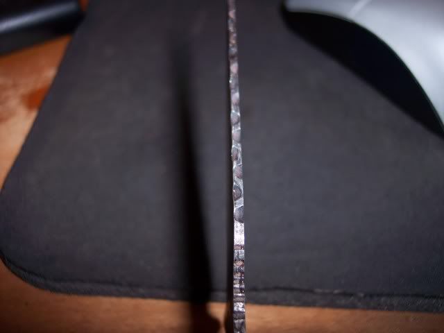

Ok, HOLD ON !!! I can't drill the blade? I burned up a bit yesterday tryin to drill one hole. I filed the edge on the knife got a OK angle on the blade.....it's a blade now because it has a cutting edge right? purty sharp too I might add....
Ok maybe the bit was dull It might have been used for something else and put back in the case. I'll get another one (or 3) today and see after the gun show. the blank was in the same hot coals.
Why would one end be workable and the other not?
And I got a used toater oven at Savers too $4.99 gets nice and hot too. Be nice for warming epoxy too when I glue up the next bow.
any ideas what happened..............or didn't happen?

GW, did you used some oil to lubricate that bit while you were drill'n?
Traditional Bow Hunting: So easy a caveman can do it!
Re: knife build along
Post by Greywolf » Sat Sep 05, 2009 5:09 pm
No, but then again I never have drilling metal unless I'm gonna be drilling a lot of holes(over 10 holes with one bit)

Hmmm,if you can't drill it theres only two reasons I can think of that would cause that.first is that it did not anneal properly meaning that it did'nt get hot enough and or cooled too quickly,in the winter time here when I have my fire place going I will throw knife blanks in the fire amongst the hot coals and leave them all night and in the morning when I get up and the fire has died down take it straight out and what was hard steel will drill rather easily.Next would be as you are thinking maybe the drill bit itself just be sure you take your time and drill slowly.

Greywolf wrote:No, but then again I never have drilling metal unless I'm gonna be drilling a lot of holes(over 10 holes with one bit)
hmmmmm. I use an oil lube everytime I drill anything metal, otherwise I cook the bit. Now, I've never tried to drill annealed metal so oldpaths can have the final say on this one.

Yes sir VT,I would definetly use some oil when drilling steel

Yessir that point on the spade bit just curled right up no match for this knife blank
Just kidding.... :rolf: it was a dull bit to begin with after I got to thinkin about it.......I'll get another after church tomorrow :P

Now I would just like to say I'm not sure what kinda steel you are using and when you say 2 hours in the oven @ 350 deg that may or may not get you a desired temper on your blade and that is kinda why I posted the color chart.
This steel I'm using here is some steel that I have made quite a few knives from and through (trial and error) the recipe I'm using seems to give me a pretty good blade that's hard enough to hold a good edge and and not too hard to sharpen.I just want you to know there are so many variables to steel and knife making that we have only scrapped the surface on this build along, but hey ya gotta start somewhere and you are off to a good start.

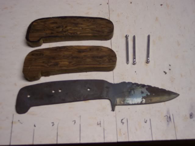

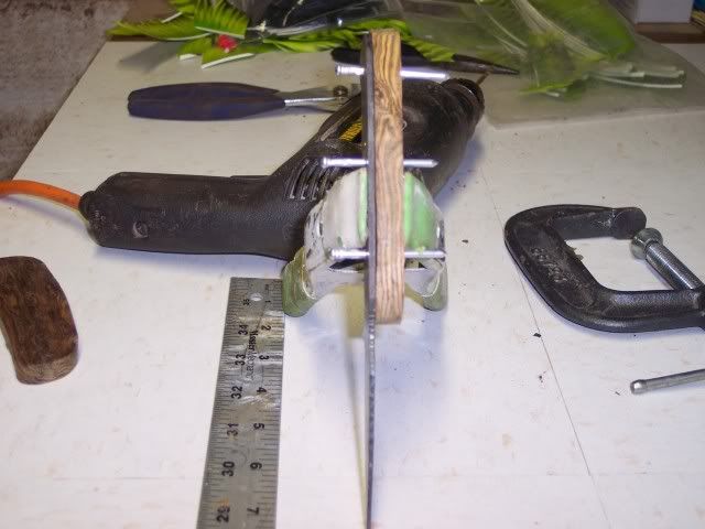

Ok pete here is the pic you requested the blank is 7 1/2 inches long.
It's a couple pieces of Bocote I had left over thought it might make a nice lookin handle.

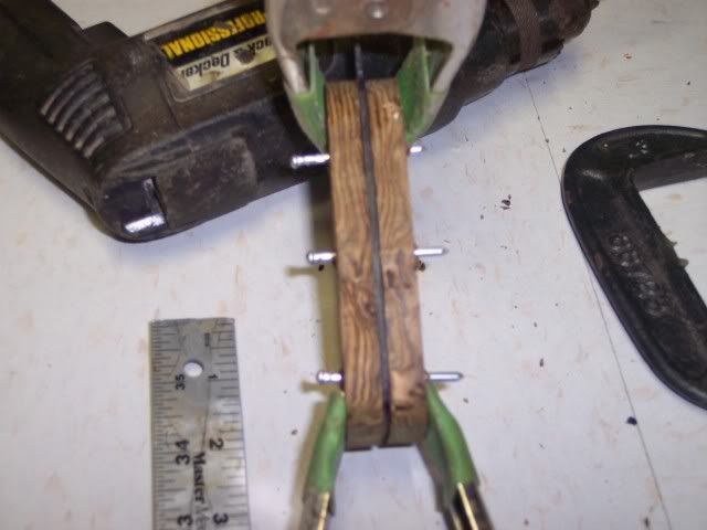

I made sure the side was exactly where I wanted it and drill the three pins and where they were to be.
I drilled the other side same as the first plate and slide the pins into place to make sure they were the exact same position.

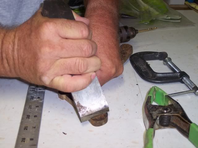

Happy with the way they look I pulled them apart and used the toothing plane blade to rough the inside of the sides on both pieces.
I also roughed up the blank handle area too on the grinder, I just kinda let it bounce along and scar the metal as it happened on both sides.

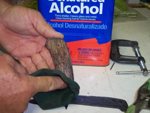

Using my favorite cleaner 95% denatured alcohol I cleaned everything wood and metal alike.
I mixed up some epoxy and spread it on all surfaces, Grabbed some C Clamps and pinned the handles in place. I put it in the toaster over at 150 degress for 3 hours. after it cools I guess the last step is shape they handle to the way I like and fit my hand. ready to get toasted !!

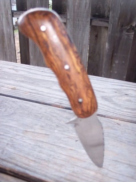

Post by Greywolf » Fri Sep 11, 2009 12:14 pm
Not done yet but close, still trying to get it to fit my mit size hands....
I guess, I shoulda turned the picture first sorry bout that........
