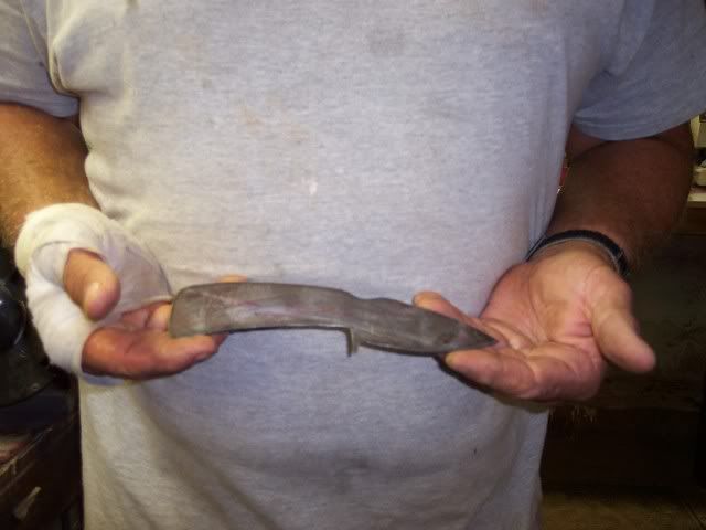

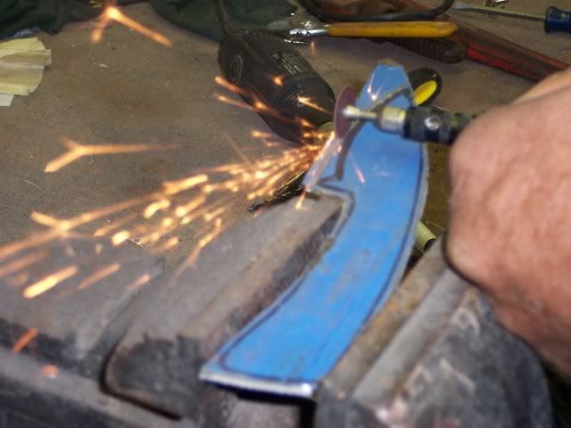

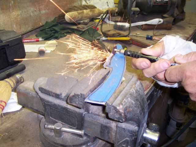

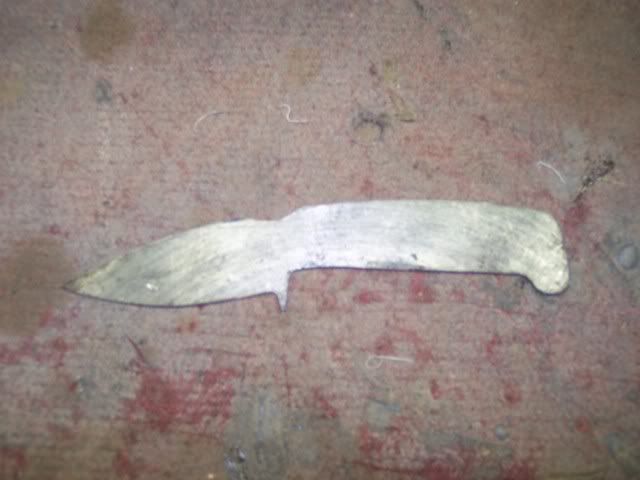

Next thing I need to do is remove my knife from my stock and I just use my 4" grinder with a metal cutting disc,just be carefull it can be a dangerous process if the grinder kicks back on ya or the disc jams up and breaks in peices
I try and just cut the main chunk of steel out leaveing all the lines of my pattern intacked and then grind down carefully to my lines
here is what I got from the removal

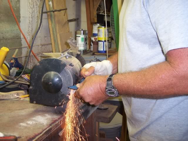

and here I am carefully grinding down to my lines and might I say skillfully takeing a pic at the same time (LOL!)

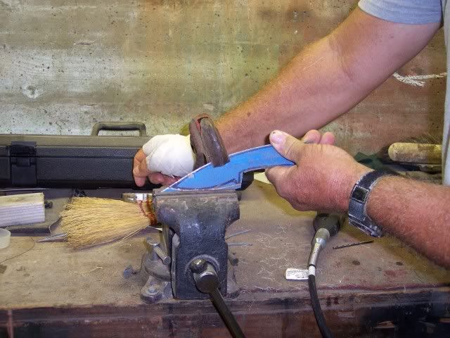

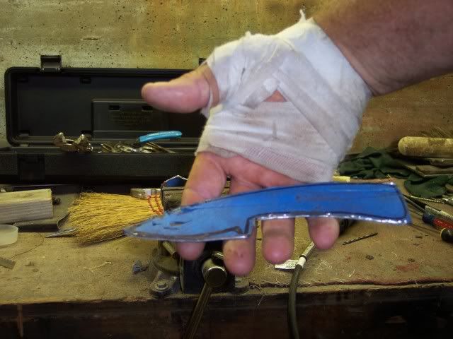

Back at it,now that I have my knife all profiled I need to drill some holes for my handle pins but this saw mill blade is pretty hard so I will need to anneal it.;for this build I will be using my one brick forge but you can use any fire you got as long as you get it hot and I mean a nice glowing red but not too hot to where its trying to sparkle or melt,now I will take it straight from my fire and place in my little preheated toaster oven so that it dont cool too fast because if it cools too fast it will probably still be too hard to drill,or you can just use any means of fire to get it hot and leave it buried in the ashes untill it completely cools down.For this knife I will be heating the whole piece of material and tempering the blade afterwards but in the past I have been successful by heating only the handle area for drilling purposes.Here is a pic of the knife going into my big fancy forge
Now that we have our blank properly annealed we can go ahead and decide where we want to put the pins and drill which is what I'd recommend but I got excited and went ahead and began fileing my angle for my blade and since I have properly softened the steel it goes fairly easy with my hand file,some makers have and use nice belt sander's for this part or some sort of jig to get the desired angle but I just eyeball it and with some practice and patience you can get a pretty good blade worked down.Here is a pic of my precision method of fileing an angle on a knife blade
not too bad if I do say so myself (LOL)

Ok, First off I have no idea where the first two pictures went they were the knife that I drew on the saw blade.
So I'll jump to the cutting of the blank.... the first cut was across the top, I found out you can score a saw blade then snap it off. now I know why they use saw blades to make knives !!!! ok here is cut number two...
Little better view, first time using a dremel tool cut off wheel..........it's so tiny. I was going to use my big honken grinder but I wanna see how this works.............miniature style :rolf:
Like I said you can snap the steel along the scored line, just go easy, the pipe wrench is just because of my injured hand
easy back and forth it'll snap right off
See in no time at all you got a roughed out knife.......darn looks like I know what the heck I'm doin huh?
I guess the next step is the semi final shaping on the grinder.......oh when you do this don't wear slippers, the sparks burn like crazy
Pretty soon you have a nice looking blank
It just didn't feel right in my hand(forget the bandage part) so I removed some more end and put a drop down on the end to keep the knife from sliding as I added this
Ok, thats where I'm at right now, I need to build a fire and anneal this blank so I need to go to the store and buy a package of hotdogs just in case the fire dept shows up, So I can say, by their own regs I can cook on a open fire. Who said we former Hoosiers aren't smart !!
