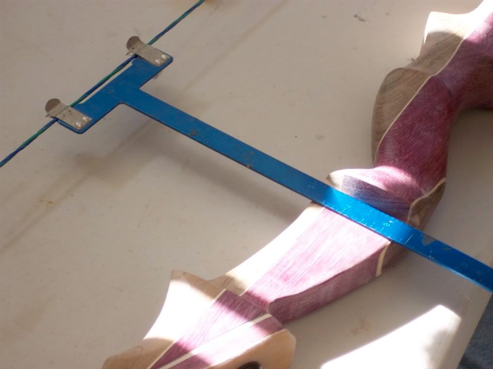

I use a string square, clip it on the string and slide it down to the shelf or rest. now mark the top of the square, this is where I start the serving, see told you it was simple.

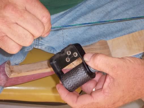

Thread the tag end through and leave 8-10 inches hanging out
Then start winding the server over the top so the serving is winding to the right bout 3-4 turns, then I take the tag end and lay it along the string towards the handle and serve over and continue to wrap so it's now the tag end is under the serving.
Here is where you set the tension on the wing nut that controls how much tension is placed on the serving spool, I do mine with some tension but not so it will pull out easy, I like a tighter serving.
Continue about 10-12 more wraps then I take a pair of hemostats and grab the tag end and pull it tight so it will be tight under the wrap by pulling,locking it under the wraps.

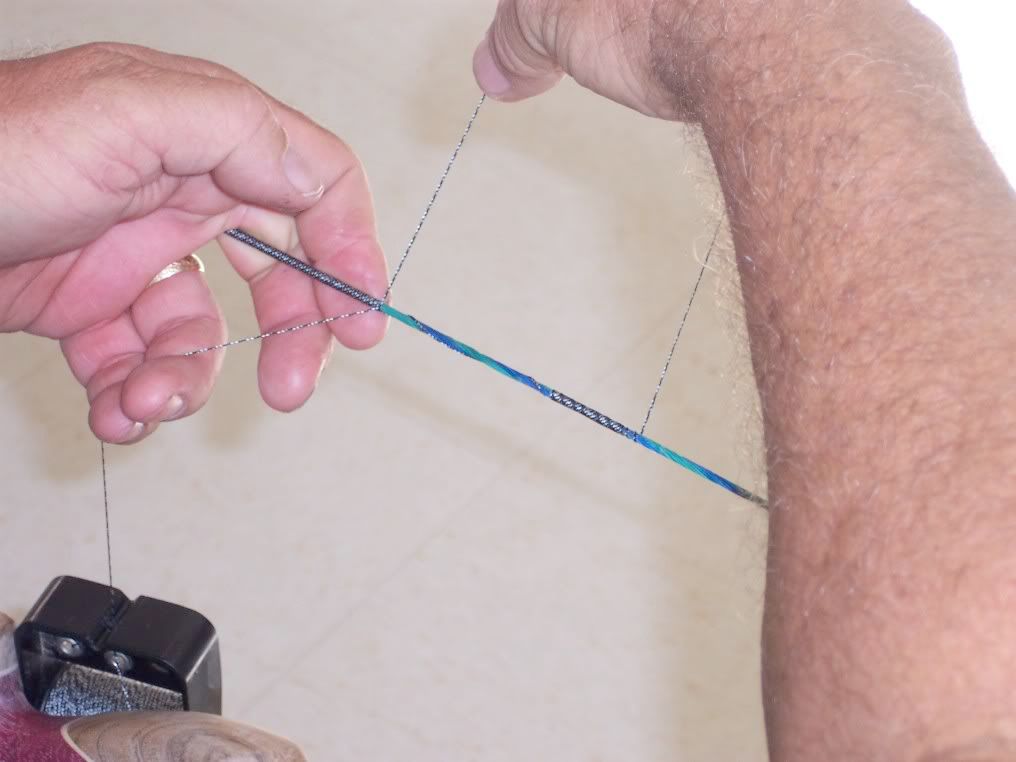

When you reach the length you want, now pull the server towards you unspooling about 10 inches of string, take your left hand and place 4 fingers on the serving and loop it around your hand and put the server over the string like your going to serve again like you just did, because you are.
Holding the loop open, place the serving tool inside the loop and serve inside the loop, going back towards the center serving you just completed
Now serve inside the loop just like you did on the string, for 12-15 turns (you can do less I don't want my serving to move)
Good!! Now for the close, This part is little tricky, pull out 10 inches of serving and lay the tag end over your left hand and let the server hang,(now the tricky part) which hands so the right index finger is holding the loop, remove your left hand and pinch, the end of the center serving and the tag end so it won't come loose.
Now winding the same direction as the server, wind the loop on the string, it'll unwind on the right side of the loop and wind up on the center serving side.
Keep pressure on the loop as you go, let you left finger and thumb catch each loop as you go, now keep winding till there is no more string left, now you have a large loopImage
put the hemostats or something with a point inside the loop and hold pressure on the loop to keep it tight, now grab the serving tool and wind the string tight to the spool, now pull the serving so it will pull the loop under the end of the serving you just did, till the loop disappears under the serving, give it a couple of snug up pulls.
